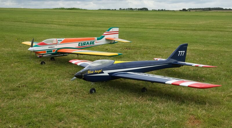

70's

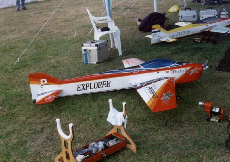

Replied by JonTappin on topic aerobatics design theory
80's (late)

Adrian wrote: Canilisers! thats what those things that are a bit reminiscent of F1 from a few years back are called!
thanks Jon, that's exactly what I was after :-)
so....
in terms of profile,
if we take a line from the motor shaft down through the wing centre line then tail should be in line too. keep as much area as possible in front of the CG.
Pretty much, yes
does the position vertically of the area affect roll coupling? eg if more than 50% of the area was above the motor/wing/tail line would it give roll coupling?
what about fin/rudder area should that be kept as close to centre line as possible too?
Truth is everything has an effect in some way, because of the lower tail the fin area above will always be greater than below the tail. The good news is that roll couple can easily be removed with a mixer
plan form:
Straight leading edge should give least yaw to roll coupling?
No straight or swept leading edge has little affect on roll couple, height of wing above or below centre line and dihedral angle are the main issues
Last edit: 15 Oct 2015 23:04 by JonTappin.

15 Oct 2015 23:01 #6518 by Adrian
Replied by Adrian on topic aerobatics design theory
looking at those pictures F3A really hasnt changed that much other than gaining some side area.
all have straight trailing edges, lowish wings, motors appear to be on the tail line.
