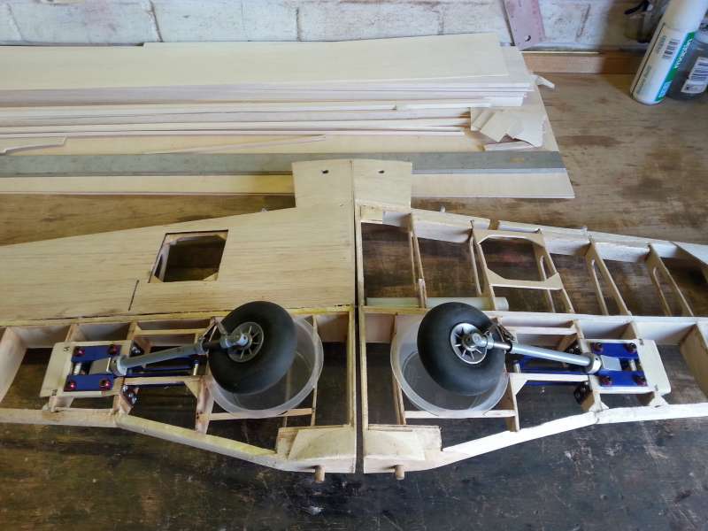

progress so far with the wing rebuild!!

Blimey Chris. A bit of a project! More than a rainy day just job then. How long have you had that Mustang laying around? :lol:
