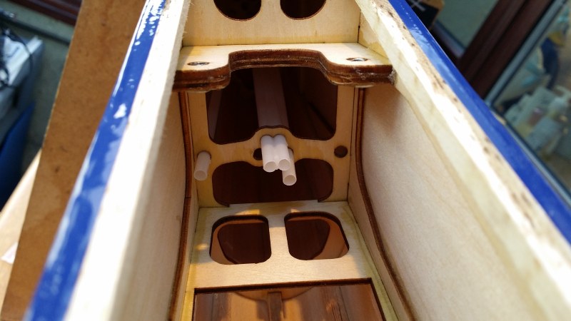

26 Nov 2015 17:17 - 27 Nov 2015 09:36 #7156 by Phil Ford
Replied by Phil Ford on topic Christmas Curare EP
This stand-off issue really had me going. :( But this morning I am thinking - Hangar 9 Mustang came with 48mm stand-offs for electric. But I fitted a gas engine! Then there must be somewhere in this house 4 stand-offs. After an hour of searching found them in the roof still bagged up. :) Simple job to cut out four 20mm bits and drill out to 4.5mm for 4mm set screw clearance. Motor mounted, cowl position set and fixed. 2mm clearance between cowl and spinner backplate.
The qefimagazine electric review isn't that helpful as such, more of a skimp through. Jon's build/review much more helpful. ;) although for glow. ;) Since these models were reviewed, some changes at the factory have been done. The snake tubes are already fitted. There are four now, two for elevator rods and two offset for pull pull rudder. The single rod to rudder is discontinued. However to get a decent pull pull arm in to match the rudder horn width I have had to put the rudder servo where the throttle servo would've fitted.
The pull pull wires will now go under the elevator arm as per the original build instructions.

29 Nov 2015 17:24 - 29 Nov 2015 17:25 #7203 by Phil Ford
What a carry on!
Firstly you have to use a double arm for the pull pull maximum width 44mm. Using the link connectors on the outside holes equals 40 mm the same as near minimum of the rudder horns. Manual shows clevises screwed on to couplings with pull wire threaded through. All done, hello we have a problem. :(
The clevis and link nearest the elevator servo won't clear it! Pondered this issue for while and decided to forget the manual and do it my way to achieve the proper outcome.
Do away with clevises use the connectors and slide the wire links through the connectors. This now gives some adjustment if needed to the pull pull and also the wire just slides by the elevator servo body. See images.
Last edit: 29 Nov 2015 17:25 by Phil Ford.

  • MikeSeale
29 Nov 2015 17:41 - 29 Nov 2015 17:43 #7209 by MikeSeale
Replied by MikeSeale on topic Christmas Curare EP
The rudder servo installation still looks a bit 'clunky'. A simple solution is to raise the rudder servo until the wires slide neatly over the elevator servo.
You also have a little movement on the rudder horns where you can bring them in a little bit more and then bring the linkages closer to the centre on the servo output arm
Last edit: 29 Nov 2015 17:43 by MikeSeale.
29 Nov 2015 17:48 #7211 by JonTappin
Replied by JonTappin on topic Christmas Curare EP
Or just pack one servo up so the arms clear each other
