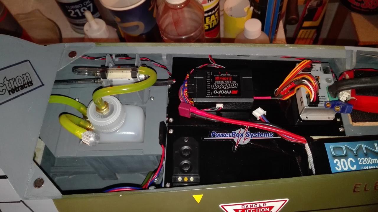

8 years 11 months ago #9803 by flyingpete
A couple of install pics
8 years 11 months ago #9804 by Phil Ford
Replied by Phil Ford on topic Pete's latest creation
That's a really tidy install Pete. Hope Dave B reads this....... :evil:

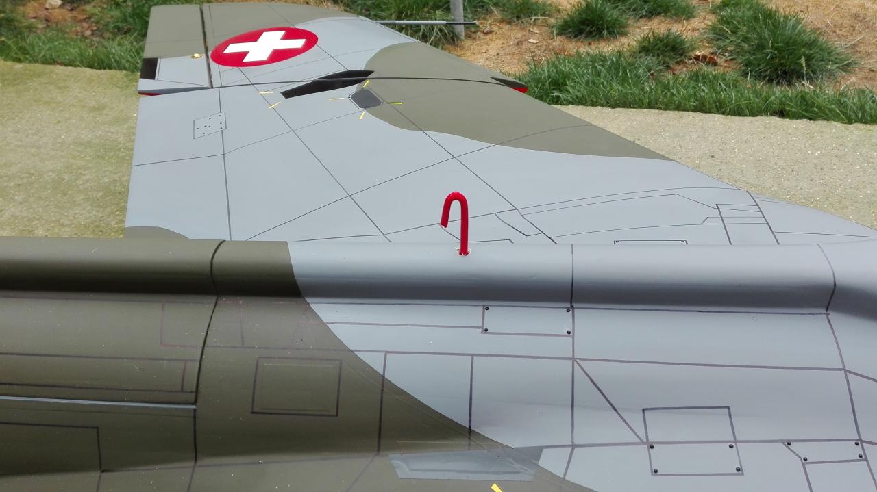

During construction I glued a 1/4 ply plate over the c of g position on the top keel so I could screw a hook in to pick it and check balance and then plug the hole with a dummy strobe beacon.
With the gear down it needs 900g of lead and gear up it changes to 700g.I will go with the gear up position as that will be the normal flying attitude.As I have put the main 3.2 ltr tank bang on the c of g no change was measured if full or empty.
