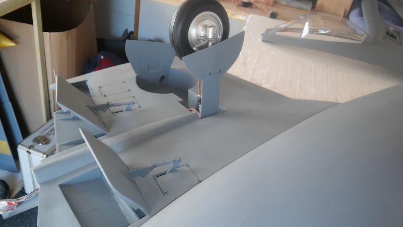

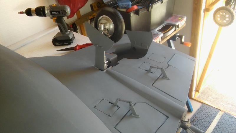

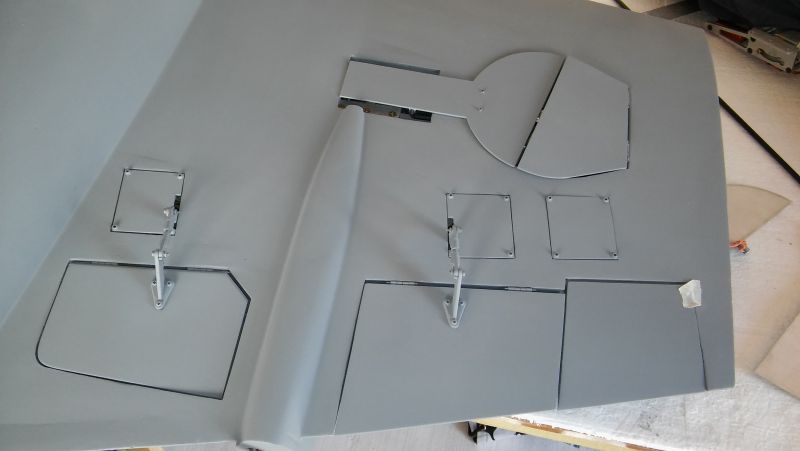

9 years 5 months ago #8775 by flyingpete
Replied by flyingpete on topic DH VAMPIRE
Now that i have moved and built my new workshop, it's back to business!! Hear are a few pics i have taken today. My favourite pic is the one with everything deployed, can't wait to see that at cashmoor on a low slow pass B)

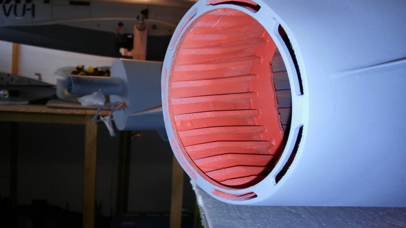

9 years 5 months ago #8776 by flyingpete
In picture two you will see the red paint i have applied to the pipe tunnel. This is to stop the balsa catching fire fro the heat from the jet pipe. This paint will withstand temperatures of 700 + degrees.
