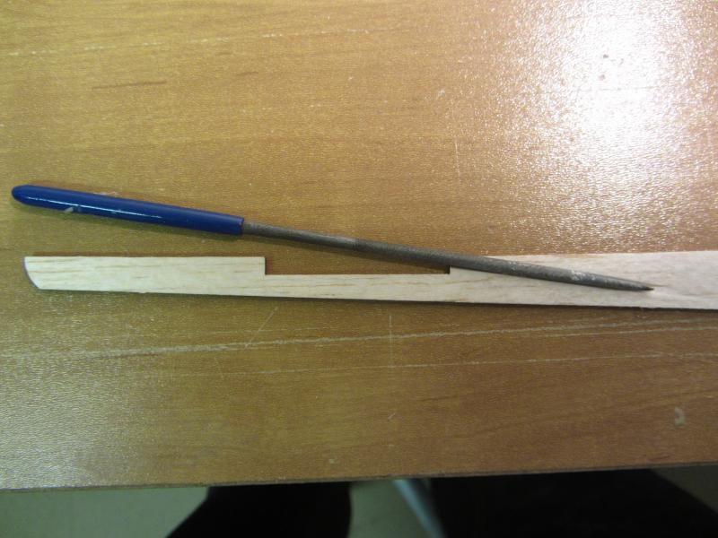

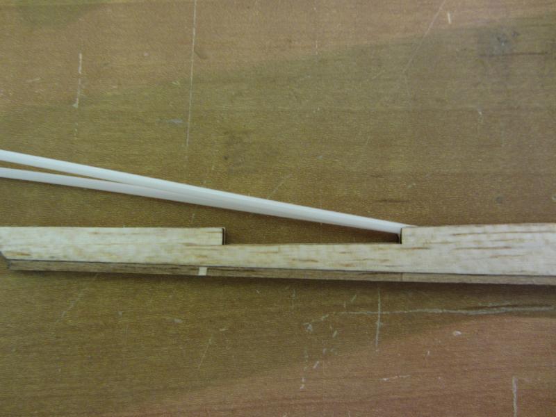

I've made a start on my Minus Acro. It's the same fuselage as the thermic but the wing is straight (no polyhedral tips), it has a symmetrical section, and shorter wingspan (0.7m instead of a whopping 0.9m). With the benefit of hindsight, I have made a few very minor alterations to the fuselage construction.
Firstly, the tubes for the elevator pushrods were originally glued as straight as possible. This meant that the pushrods are under tension in the finished model as they are forced towards the elevator control horn. I've changed this so the tubes are angled upwards to hopefully relieve some of the pressure. I doubt it will make any difference to the way it flies, but it will make it a lot easier (I hope) to set up the linkage when it's time to install the radio.

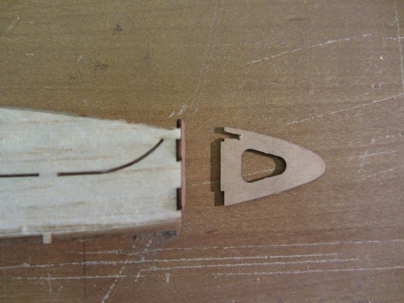

The second modification is at the nose block. The centre of the block has a ply keel. Later in the build you are supposed to drill through this to make the canopy latch. Unfortunately, the drill wanders off centre into the soft balsa which is why I could not get the latch working satisfactorily. So I've cut a small slot in the ply prior to laminating it. It is doesn't help I can always revert to the magnetic latch but I'll see how this one turns out compared to the first attempt.

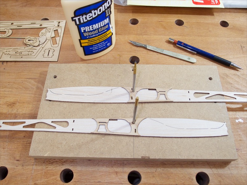

The first job for me was to knock up a quick jig to enable accurate alignment of the fuselage side and the plywood doubler. How anyone could possibly glue these two pieces together without such a jig is beyond my imagining ;)

I didn't use a jig on my first build. On the second one I used the carbon wing joiner to make sure ply and balsa were lined up. Kept using the joiner to make sure it was square while I glued formers in place. One deviation from the instructions was that the rear fuselage was taped and not glued at this stage...OK, I did glue it but on both of mine it ended up being slightly banana shaped, so had to be split in order to attach the fuselage bottom before re-gluing.
