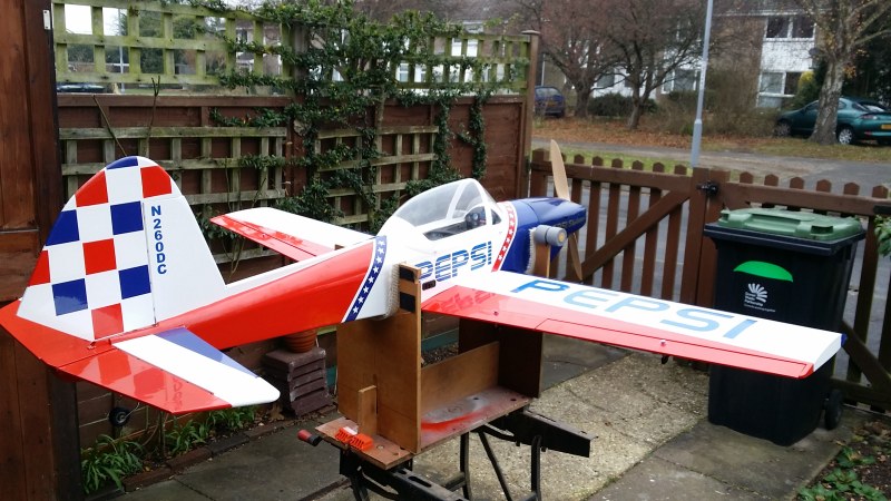

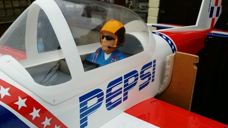

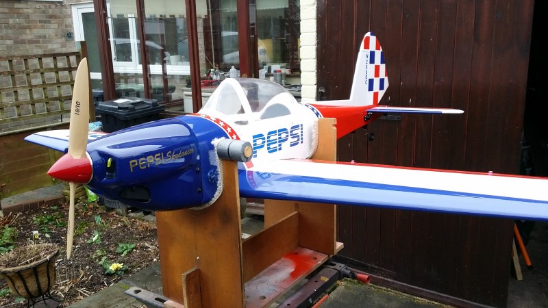

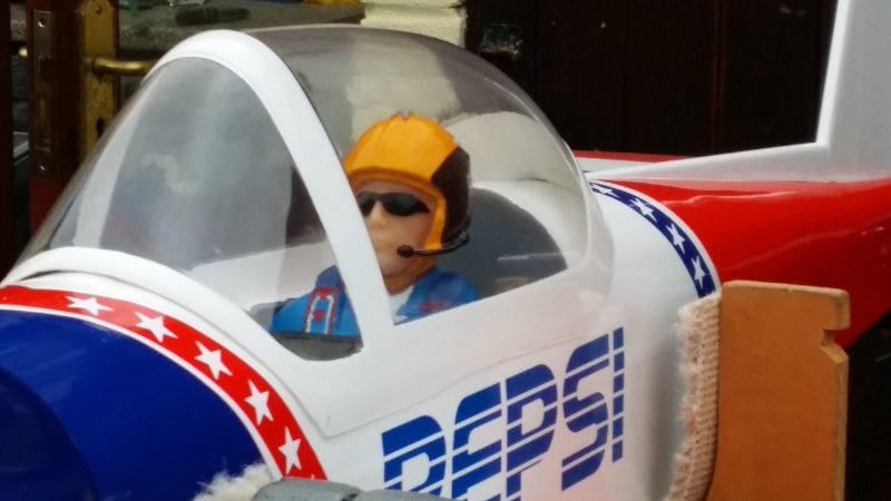

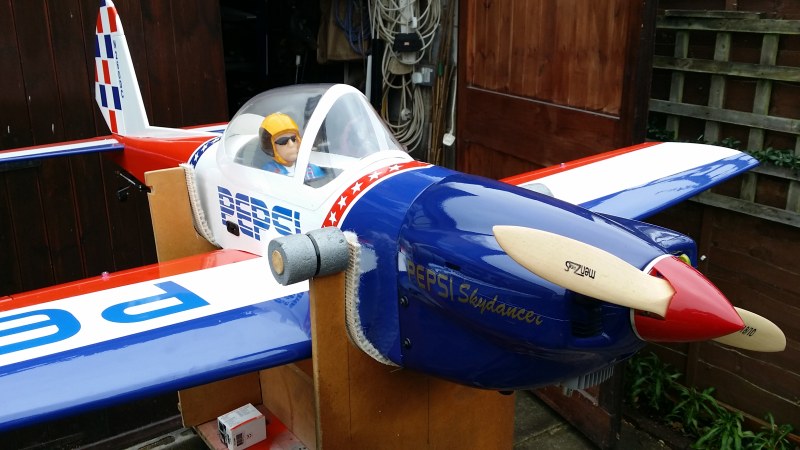

Today must be the soggiest dull day so far. However, got a tiny bit of momentum again on the Pepsi. The spat brackets did not turn up in the post today so I quickly dived outside and placed the wing on to the fuselage for only the second time. The blue wing line is near enough to matching the blue livery on the fuselage. Hanger 9, 1/5th scale pilot is nearest to scale size, the 1/4 scale Piper Cub full pilot model is a little to big. (and he isn't wearing shades ;) )
As soon as the landing gear is fitted and spats painted up then a dry warm day will see first start up. :unsure:

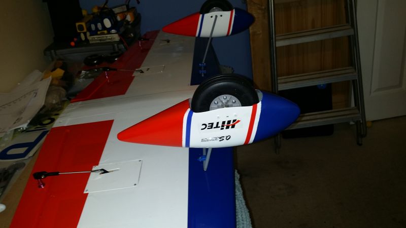

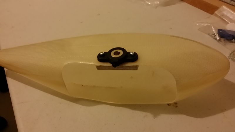

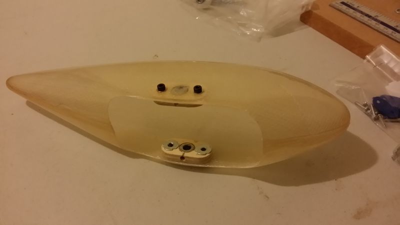

Purchased some Hobbico spat mountings. I am going to use these rather than the Pepsi plan build version which is the same set up as per my Pennzoil. I found that the spats do not stay locked in position on Pennzoil in flight, even with flats ground into the axles as the ply gradually gives way. One always decides to hang down a bit. :(
So, for Pepsi I am going to try these handy items, hard plastic and quite sturdy. An extra long 4mm grub screw goes through the fitting, wheel collar and will sit in a flat on the axle. First image is the plan version and the second image is the Hobbico version. I just have to make up some ply blocks with metal inserts for the opposite sides of the spats to support the far side of the spats

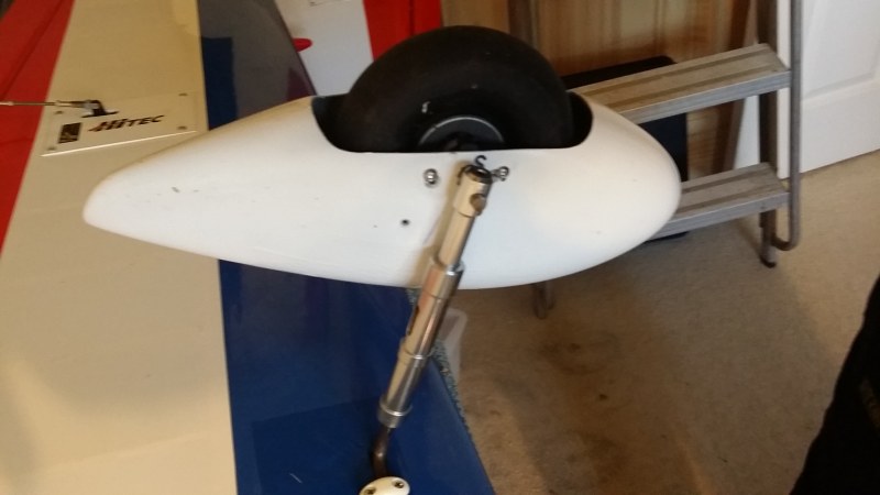

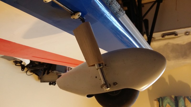

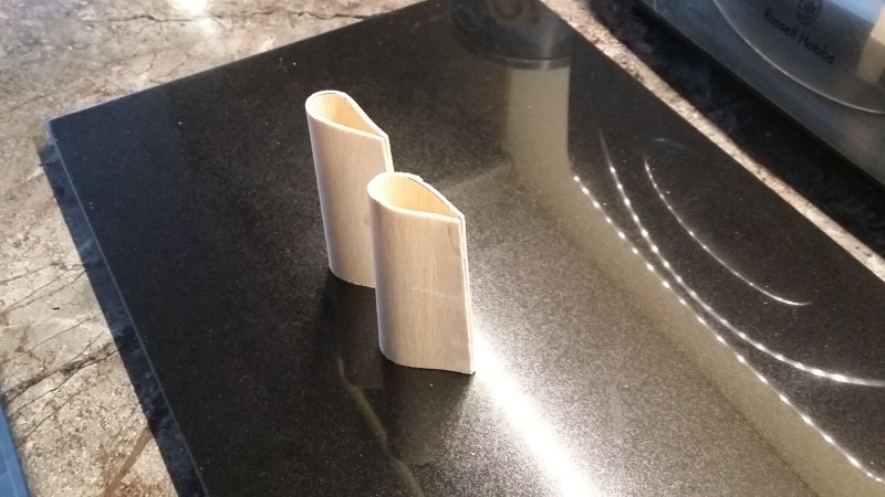

Managed to push myself into doing something constructional today. I have made up some fairings using 1/16th balsa as per the plan. Except I made these to wrap round Oleos rather than 4 SWG piano wire. They slide on nicely as you can see on the test fit using Pennzoil Chipmunk wing as it already had Oleos fitted to test before covering with film. But for my money I think they could do with another 25mm in height.
The modified spats now have extra wide axles to allow the spat to clear the Oleo whilst the spring is in action.
Which brings me to another point. Anyone got any spare 1/16th balsa sheet 100mm wide at least so I can make up some more fairings?
