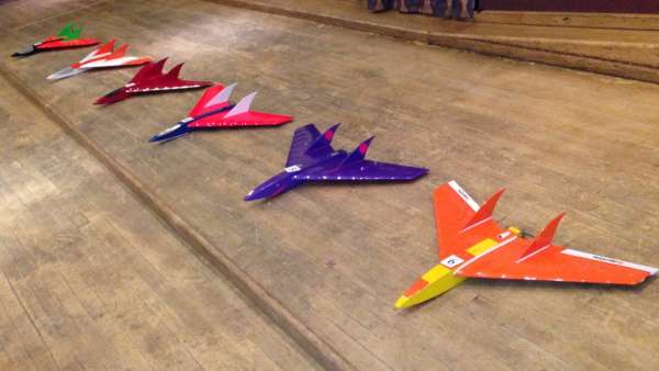

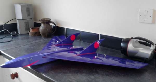

Here is the Pink Lady. Its the eyes what did it.
Phil, the hook is fixed, not releasable, so we would need a drogue to pull it off the hook when you stop.
However, Mike's method seems to be good.

DavidTappin wrote: Phil Coupe won the "best Impressivo" comp at skittles last night. A team of three ladies, specially selected by me to ensure no Impressivo owners wives got the chance to show favour, were the judges.
Congratulations to Phil C (through gritted teeth :) )
DavidTappin wrote: But then I suppose if you chose a girly colour it will appeal to females.
That was my tactic, but I failed :(
Last edit: 28 Feb 2014 12:40 by JonTappin.
28 Feb 2014 13:42 #1431 by DaveBright
Replied by DaveBright on topic WMAC Group build - Impressivo
Last night's entries
28 Feb 2014 18:05 #1434 by Dave Rogers
Replied by Dave Rogers on topic WMAC Group build - Impressivo
6 of em not bad at all. Hope you all had fun.

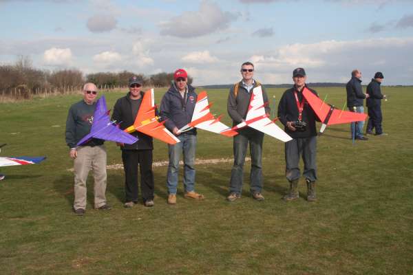

Five were up today. Kevin's and mine had already flown and I did the hand-launching for Simon, PhilC and Jon, with Jon doing the trimming flights for Phil and Simon as well as himself. All successfully up and down in one piece. Motors and ESCs are coming down cool even after extended runs at full throttle. Batteries are warm but not excessively so. I broke another couple of props. Before my last flight I measured the current on a 5.5x4.5 at 57A compared to Kevin's 44A on a 6x4 (not an APC and with a different battery). Didn't measure Jon's current but in flight with Kevin and Jon mine was noticeably the quickest which was put down to better battery - a 35-70C Turnigy Nanotech compared to Jon's 25C Thunderpower. Last landing was a bit hot and it flipped over ripping a small section of covering/hinge material. Easily fixed but it put paid to my afternoon.
When we were flying three together, it was interesting trying to find the same piece of sky to fly in. These things are quick and their small size adds to that impression. Occasionally, we were close together and managed a few low, fast fly-by's. Not sure what it looked like from a spectators point of view. Perhaps we can get some feedback here?
Looking forward to next time when we can hopefully have a few more in the air together. There's a photo out there of the five of us looking incredibly cool, ie. not at all nerdy.
Mike

As promised, a picture of a bunch of nerds :)

01 Mar 2014 21:19 #1452 by JonTappin
Replied by JonTappin on topic WMAC Group build - Impressivo
Sorry that's such a poor quality photo, but for some reason, whatever the size of the original I upload, it comes out as 26kb :(
