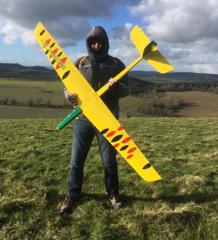

I took two models to the slope today, the Begin'Acro and the Minus Acro. The minus has a span on 700mm and weighs just over 100g. I have flown it before and this went first. It really struggled to penetrate at first but eventually flew ok even though it was severely affected by the gusting conditions. After about 10 minutes I decided enough was enough and my fingers were frozen.
I had hoped to maiden the Begin'Acro at Cashmoor on a calmer day, but since the Minus was such a handful I decided that today was going to be the day. I used two 8mm neodymium magnets to hold the canopy on but just as Chris launched we both saw the canopy shift. It stayed on for about a minute before heading downwind. Chris followed it and found it about 200m away. I really wanted to fly again but had nothing to secure the canopy with. Then it struck me that the Minus ailerons used a tape hinge, so this was removed and used to hold the canopy on for the rest of the day.
The Begin'Acro flew better than expected in this wind. Very stable and good aerobatic capabilities both upright and inverted. At one point I decided to see how it would climb with motor on - note to self...make sure you set the brake on the ESC otherwise the prop will never fold. A quick landing and several more flights without any motor completed a very enjoyable afternoon.
