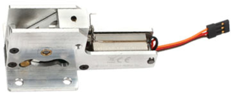

Now at last as promised E-Flite, a well known brand in electric models and power systems has come up with a good alternative - yes, electric retracts. Kits for the small jet 15 size to 120 size models.
You can choose between a pair of mains or a complete tricycle set. This review will concentrate on the EFLG430 60 -120 size trike set although most of the ancillary parts are standard over the range. The triike set comes with chrome spring wire, 5mm for mains and 4mm for nose leg. The mains legs are locked by two each 3mm grub screws. The nose leg is pre-assembled with the steering arm integrated which is lightly sprung loaded to return to centre.
The retract units are well made using aluminum for the housing and the retract hub. A powerful motor spins a worm gear to operate the mechanism. A brass pin sliding in a guide securely locks the retract in the up or down position. Now here comes the best bit, an integrated pcb board monitors the retract and if comes up against resistance, instead of pulling the battery power down due to overload, it simply returns back to it's original position.
The units are very light considering and the kits come with chromed axles, collets and the allen keys for the grub screws. Plus you get a y-lead or triple servo lead depending on your kit. The pre-drilled 4mm holes in the 60 -120 kit are near on the same dimensions as other retracts including Robart. In my case to allow for precise alignment I drilled these locating holes out to 5mm. Theoretically, if you have had air retracts previously then it should not be much trouble converting to these electric versions. Goodbye air-leaks and air pumps!
In a scale model no more slam up - slam down gear! These units take about 2.5 secs to operate over their cycle varying slightly depending on voltage - 4.8volts - 6 volts. The difference is only about 0.2 secs!
The mains are easy to modify to take Robo struts or similar. Just take out the 5mm wire and drill out to your strut size, max I would recommend to be 3/8ths (9.5mm) I drilled out mine to 5/16ths inch to 5/8ths in depth which allows both grub screws to locked into the strut. The steering/nose leg is a different kettle of fish though - I didn't modify this one as I could suffer with wire nose leg on my model. However, removing the 4mm leg would entail stripping the leg and steering arm right down, then drilling out for your strut and modifiying the steering system also. Not too difficult a task but a little time and patience consuming!

Overall, I think E-Flite has a winner here with the quality and price. A trike set 60 -120 size as I have used retails for around £150 (Robart = £399.00!) This set is good for models weighing in at 8 -15 lbs (3.63 - 6.80 kg)
