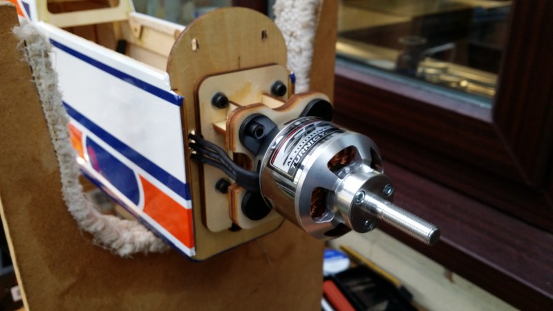

9 years 10 months ago - 9 years 10 months ago #7141 by Phil Ford
Replied by Phil Ford on topic Christmas Curare EP
Elevator rods done ;) (see stories of stupidity)
Come across another glitch. Motor install. In the qefimagazine review the motor used was the Lipolice 510Kv. I have used the Turnigy SK3 5045 660Kv. Physically they are the same size give or take a millimetre lengthwise. When the SK3 is mounted as per the review and instructions and the cowl is pushed on as far as it will go the prop driver is still 10 or 11 mm short. :(
Plus with the cowl pushed far back it now overlaps the front of the removable canopy by about 15mm. So it can't go there for starters either. :(
Looks like about 25mm short in total.
See images.
Somethings going on......... :angry: A the least i have got to add spacers of 10mm to get the driver out of the cowl and then there is the issue of the cowl - cut it down? Should'nt have to..
Scratching head - assembly stalled.
