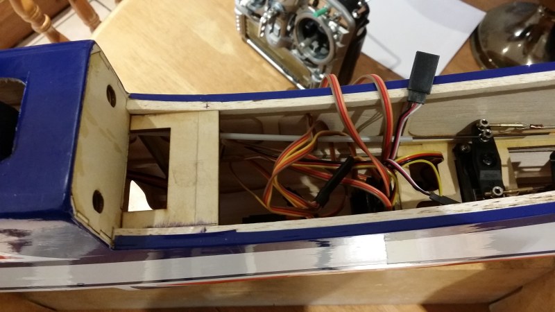

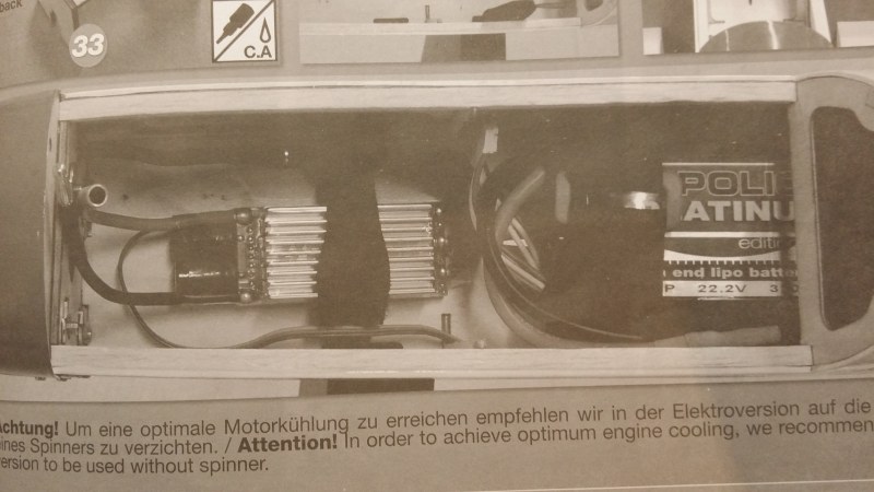

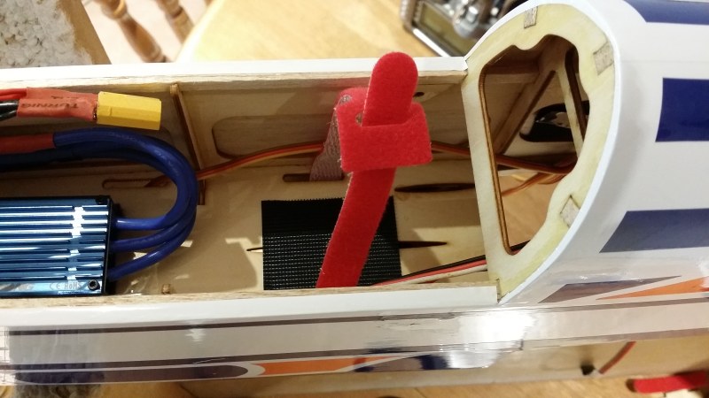

Progress so far. C of G at 115 mm appears little more realistic Jon. Lipo sits up close to ESC as per the monochrome manual image. Photo 3
When the battery is inserted in position half of it is hanging out in fuselage with no support whatsoever and no back stop either! Photo 1 & 2. This will need to be corrected. Don't want 650 gms of weight floating around regardless. Made up a floor out of the spare bits of ply in the kit. See photos 4 & 5.
