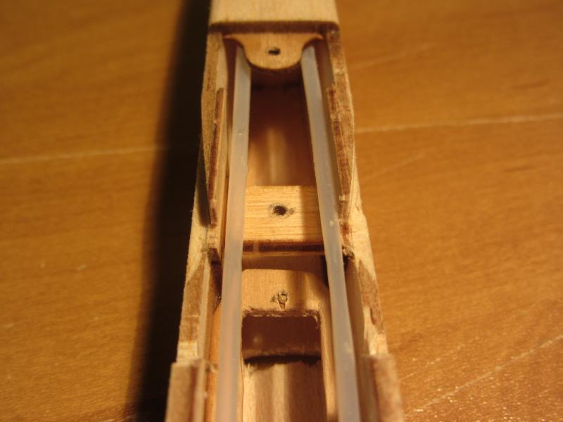

My wings did not line up perfectly. Either I put the brass tube in at a slight angle or this is how they will all end up due to the fact that the fuselage sides are not parallel. Anyhow, they needed to be pulled together at the trailing edge to hold them flat to the side of the fuselage. Also, the little tongues that hold the wings on did not have a plate to screw down on...perhaps they are just supposed to be screwed together and not down to anything. For me a plate just behind the aileron servo gives me something to screw down to and this firmly holds the wings tight against the fuselage.

And it's done, ready for covering. Did I already mention that this is small!
