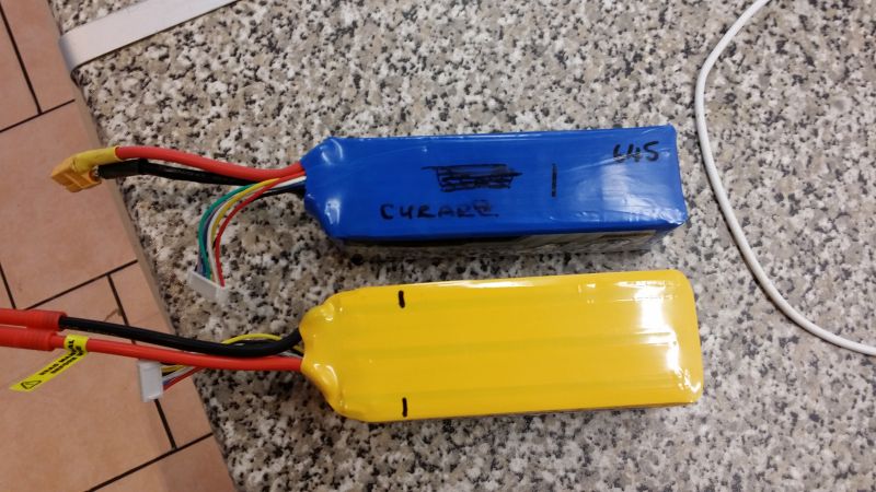

So far had loads of flights and loving it. :) With only one battery too! :(

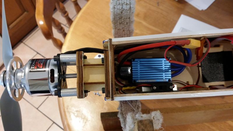

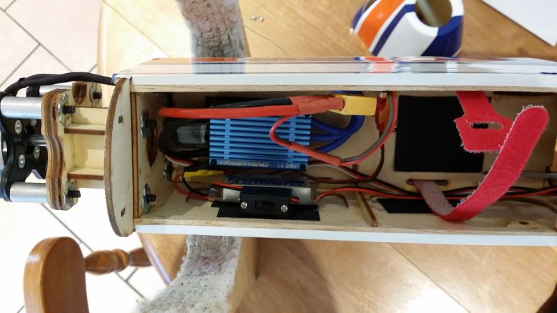

Ordered two 4000maH 60C Zippys. These are virtually the same length and height but a lot wider. Weight of these Zippys is 693gms compared to 645gms for the Turnigy. The extra width required repositioning of the regulator more forward (more juggling of wiring) but simple enough as the output wire was quite long. The new packs may have go back a little to maintain CG.
Jon, you had 16 clicks of right rudder dialled in on the TX. So, while indoors I removed the cowl and checked the firewall position and motor adaptor. There is no right thrust built in. Do you think a degree or so of right thrust would do the trick to centre rudder. Never heard you mention anything before regarding your IC Curare.

If you look at the plan Phil it suggests:
Down thrust 0-3º
Right thrust 2º
Plan: www.outerzone.co.uk/plan_files_05/5527/Curare_60.pdf
Why did you go for a 60C battery, the current handling of the motor is 60 Amps so even a 20C 4000mAh should provide 80 Amps. The 60C is heavier by about 100 grams, even more if you went for a zippy compact 25C, which is 557g if the specs are correct.

60C? I wanted a pair of 40C Zippys but only one in stock. They are only 45 gms heavier, i weight them. The Turnigy 40C I have been using has not had a lot of use, yet starting to puff out and I have not asked for max amps often. In fact the Curare has been lifting off with no head wind at just under half throttle... :) :blink:
I had not looked at the "plans" (mine is ARF) but you obviously have so I'll shim the motor adaptor for right and see if that cures the rudder trim.
As a footnote: if the new packs are too heavy, I have another plane that will love 'em, but that depends on HK stock levels of the packs I really wanted. (I did not want to go down the Europe order route after the last fiasco.
